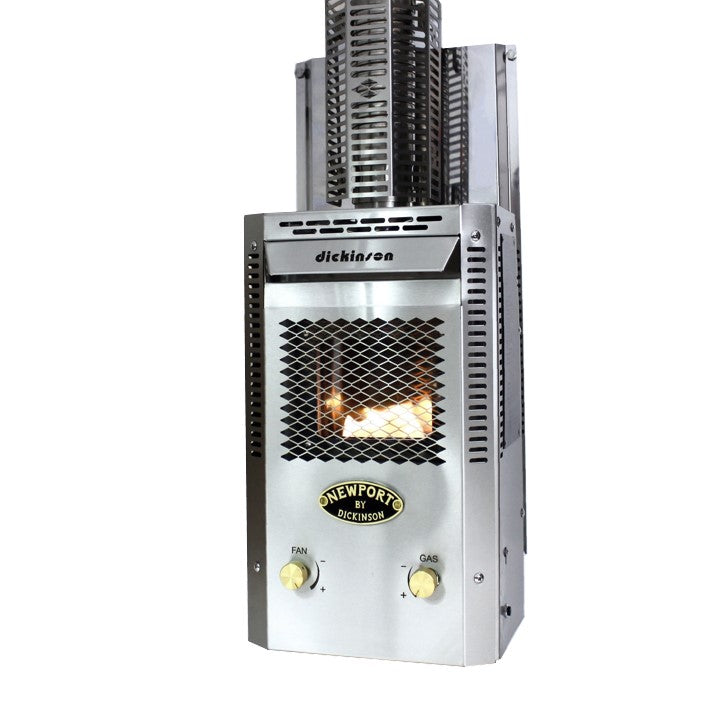

For the longest time I was considering putting a Dickinson Propane heater/fireplace in my Airstream. They’re pretty sweet.
This is the exact brand in my friends Scout camper. It’s really sharp looking, and who doesn’t like a cozy flame, but wasn’t about to carry propane myself just for an aesthetic.
