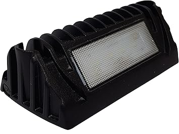

IMO a totally separate system would just end up being a pain in the rear, and in reality far more difficult than just running another wire. Are you looking to run the light for the front or the rear of the van? LED lights take very little power so in the front you can tap into your chassis battery easily, or even feed off of the running lights. IN the rear many vans have power in the rear columns at the 12v accessory outlet, or again feed off the running lights up top (Just add a small switch).
For outside LED flood light I used two different models, one I'd highly recommend and the other's just "ok".
The top one I used for up front (On both sides) and is what I would use again for all of them if I had to do it again. The light actually wraps all the way around the front of the van from this location!
The bottom one I used in the rear and I brought it through the back up camera housing, but it's powered by my house batteries. It's adjustable up and down and I chose this one so I can point it over my boat in the back. It's okay, but I don't think I would use it again as I've never actually needed to turn it.

^^^ I think that's each, but I purchased them a few years ago so the ad may be different now. I'll try and get some pictures tonight of the throw, it's quite impressive for such a small light.

I ran single 12v positive wires to them from my fused switch panel in the rear of my van. The negative connections grounded to the sheet metal. The lights supposedly work on any DC voltage between 10-30v, and I've had zero issues with them in the two years I've had them.
