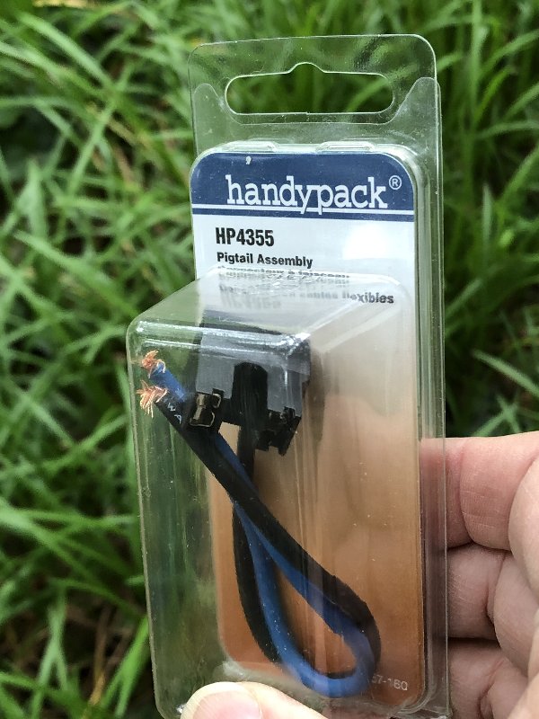

I have a '14 2500 PM and my drivers side headlight went out. When I took the bulb out to replace it I noticed the bulb was completely fine but the plastic connector that mounts the bulb melted out. Must have been getting way too much voltage. Anyone have this issue or know of the part to fix? I called the dealer but they said I would need to replace the entire headlight unit instead of one tiny part.
From what i read, they don't sell just the connector, you will need to buy the whole unit. Another option is splice out the burn out connector and connect spade connectors and rig something to hold the bulb in place. Search here in the forum on how to install led light bulb, that will give you some idea.
