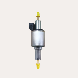

Teethandnails, where might we get a pump hanger like this beauty?
Below is the link to their replacement parts. I don’t see the mount specifically in their parts page below, so you may need to call them.
