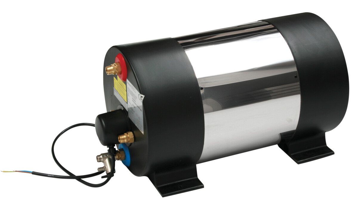

Another way is to use a 4 gallon marine water heater. It heats from the engine and also has a 110v element which could be substituted for the 12v element. This is what is used in the Rialta MH. By running the engine you recharge your batteries and also heat you water tank. After driving your water is at ~185-195* F, which last a long time.
