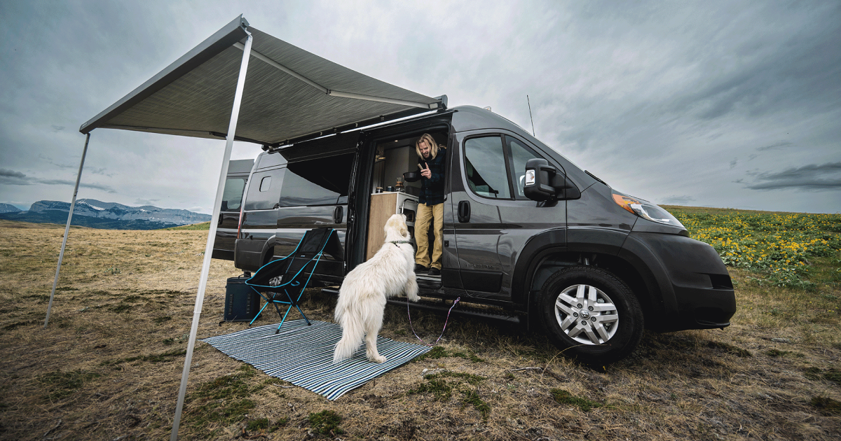

In picture the rear screen center section appears to be rolled up and secured just under awning crank.
