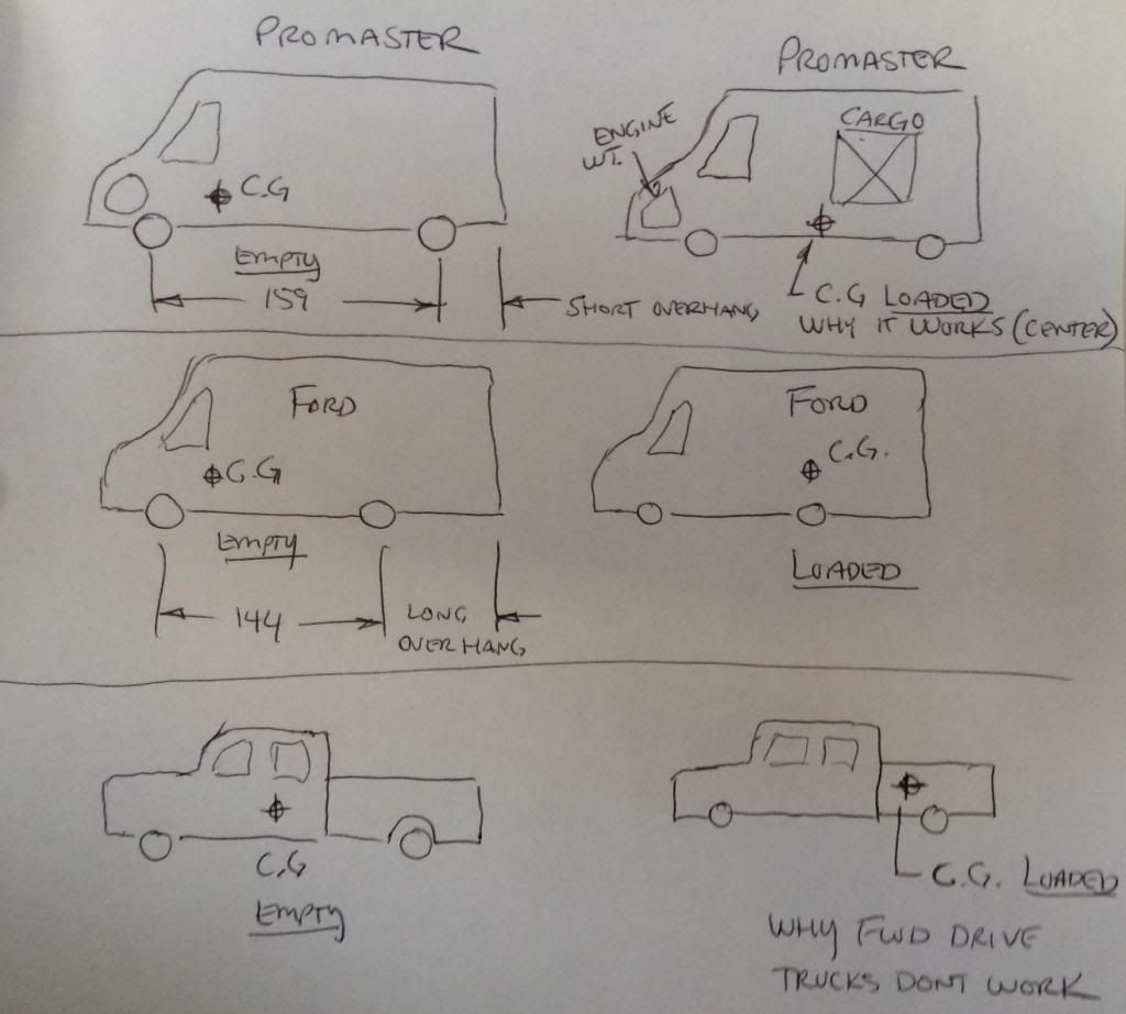

I was just reading a ProMaster review on the web, by someone clearly not qualified to be reviewing anything. This professional writer, slammed the ProMaster for being FWD and pointed out a failed FWD pickup truck done years ago. It got my blood boiling.
I threw this sketch together so show why the ProMaster works so well as a FWD drive vehicle. It's all about the center of gravity "empty" and "loaded". The ProMaster has the C.G. working in its favor better than Ford, and nothing like a pickup truck.

Even with the drawings(nice drawings by the way) they just will not get it.
Been in Europe for 30 years,but introduced here and its no good.
Afraid of change.
True enough,
but is it Art ;)
Afraid of change.
I know what you mean. I was all set to buy a Ford Transit. Then I found out they changed it to rear wheel drive. To me Ford should have just reworked the Econoline body and gave it a Mcpherson strut front end. They could have saved themselves a bunch of money. When I found the Promaster and saw that Ram didn't butcher it up, I ordered it on the spot.
