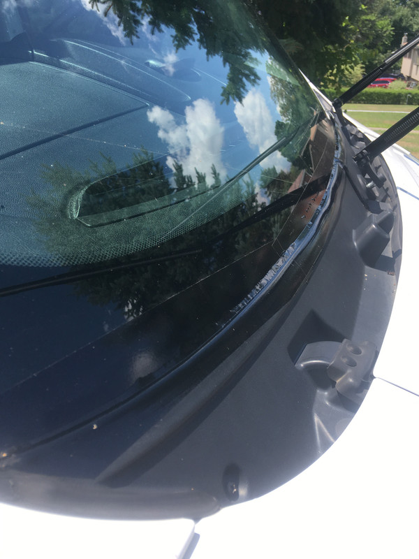

you gotta make sure you keep the drains cleared and seal the cowl to the windshield. we use 2" wide vinyl to seal it.
its not the prettiest but to the untrained eye its barely noticeable and with some patients a better job could be done. we no longer have water on the engine.
we also sealed the edges with 3m window weld cause this is the area where my AC likes to drain.

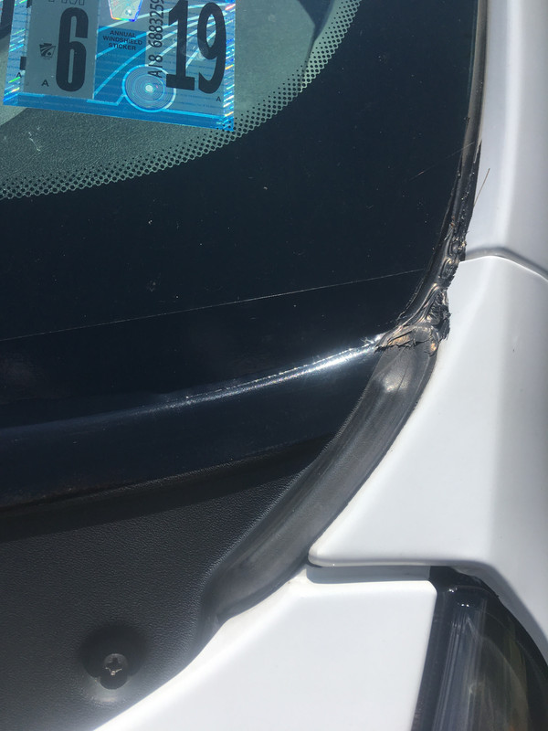

I was going to report this in a separate thread after I tested my proposed fix, but I'll post a note now:
I remember that I had read about water leaking from the windshield area into the engine. So I turned a hose on the front above the engine; enough to simulate a monsoon. Sure enough, there was water on the engine intake manifold when I opened the hood.
In my case, I believe water is entering from the vertical seam under the passenger windshield wiper. I can see how it drips onto a painted white (body coloured) piece and then drips on to the engine's intake manifold.
See pic:
There are some water drops on the white piece.
My solution would caulk the vertical seam. Or maybe as Charger7022 says, use some vinyl tape. I haven't tested my solution yet. Will post a thread with my findings later.

I did this also I had extra 3m window weld so I sealed up that joint with that. but you do have to keep after keeping the drains unplugged. I use a small piece of metal wire to un clog the small drains on either side.

I used electrical tape for the windshield to cowl leak.
Used some left over gutter sealant for that middle seam, 95% effective.
I left some 22 ga wires in the small factory drains.
I also added extra drains on the passenger and drivers side, slightly larger and don't need the cleaning wire.
