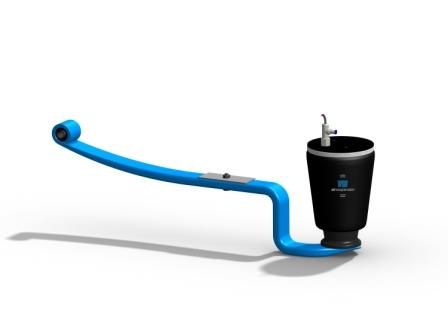

VB makes air spring conversions for the regular Ducato as well as RV/chassis versions. Spring heights can vary almost 3 inches.
There are two basic types they offer, one design is the 2c, and the other is the 4c (VB has a 1c design, but it is only for older pre-2006 Ducatos).
For the 2c design, there are two offerings, one is a rear suspension design that retains the rear beam axle, but substitutes the leaf spring for a trailing link:
http://www.vbairsuspension.com/upload/files/00001592.pdf
and a separate design for the front which seems to retain the stock front suspension linkage:
http://www.vbairsuspension.com/upload/files/00001591.pdf
and the other is a full 4 wheel replacement design that replaces the front springs with air bags as well, this looks like the 2C front and rear designs packaged together:
http://www.vbairsuspension.com/upload/files/00001900.pdf
VB also supplies helper air springs, as well as uprated steel springs. They don't supply to USA, currently. VB also sell springs for the AL-KO chassis, more on this next.

191 Posts
I contacted VB Airsuspension, and asked them whether their Ducato FullAir suspension system (the one that replaces the leaf springs with trailing arms, not just adds helper air-bags) is applicable to the ProMaster. They said yes it is.
They apparently have a limited number of "VB-Partners" in the USA (at this moment anyway; I suspect their business will grow with the increased US sales of European-type vans, e.g., Sprinter, Transit, ProMaster). I live in eastern Pennsylvania, but was advised that the closest one to me is near Cleveland, Ohio. This really looks like a great system, though, and worth the potential inconvenience.

Discussion Starter · #18 ·
Your link is a helper spring system, which is different than the Ducato system, which deletes the leaf springs for trailing arms.
The Ducato system also has a dedicated ecu for controlling ride height, and an air pump for raising and lowering the rear end, as well as maintaining ride level.

191 Posts
This product...
http://m.ebay.ca/itm/261422063504?nav=SEARCH
... misses the fundamental benefit of air suspension, which is to maintain a consistent ride height regardless of load. A second, and also missed benefit, of true air suspension is the ability to manually achieve a full-down position (to minimize the angle of a loading ram, or step-in height when working out of a parked van) and a full-up position (to minimize the offset to a dock, or to reduce bending over when loading sheet goods flat from a cart).
The stock ProMaster is already able to achieve its GAWR with no helper air-springs. Unfortunately, the way it does this is to have a rather high (and awkward appearing) unloaded ride height. I don't see any value of adding this system to a stock ProMaster suspension. Maybe if you were planning to overload it (beyond the GAWR), these might help a bit. You also might use these in combination with re-arched leaf springs (or with a leaf removed) to try to lower the stock ride height when empty, while maintaining the GAWR. But, this gets a little sketchy in terms of determining how much to weaken the stock springs.
Yes, the European Ducato air-suspension option and the VB Airsuspension system are expensive, but they look like well-engineered, fully-integrated systems. They appear quite similar, so I wonder whether VB Airsuspension is the OEM supplier to Fiat for the Ducato system. In any event, as they say, you get what you pay for.
