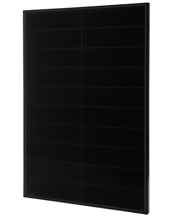

Getting down to brass tacks, at last.
Definitely going to put a PV panel on the roof. Anything in the 320w to 360w range is acceptable. I've identified these two as my most likely candidates based on specs and price:
and
Not remotely set on either, and would gladly listen to other ideas, or legitimate technical reasons to consider something else.
Will most likely be using them with this:
Still open on the charge controller. And actively soliciting ideas. I've read bunches of opinions on why people love their Victron's and Midnite's and _'s. Just haven't yet seen a compelling reason to choose one over the other, and I lack the technical understanding to make a determination based on specs.
Lastly, I think I'm going to commit to 2 x 400ah AGM's. Yes, moving them will take some deliberateness and no small amount of struggle. Not open to lifepo's nor FLA's, but will listen if someone wants to convince me that 4 x 200ah's is going to be better in some way other than on initial install.
Any opinions appreciated. Thanks in advance.
